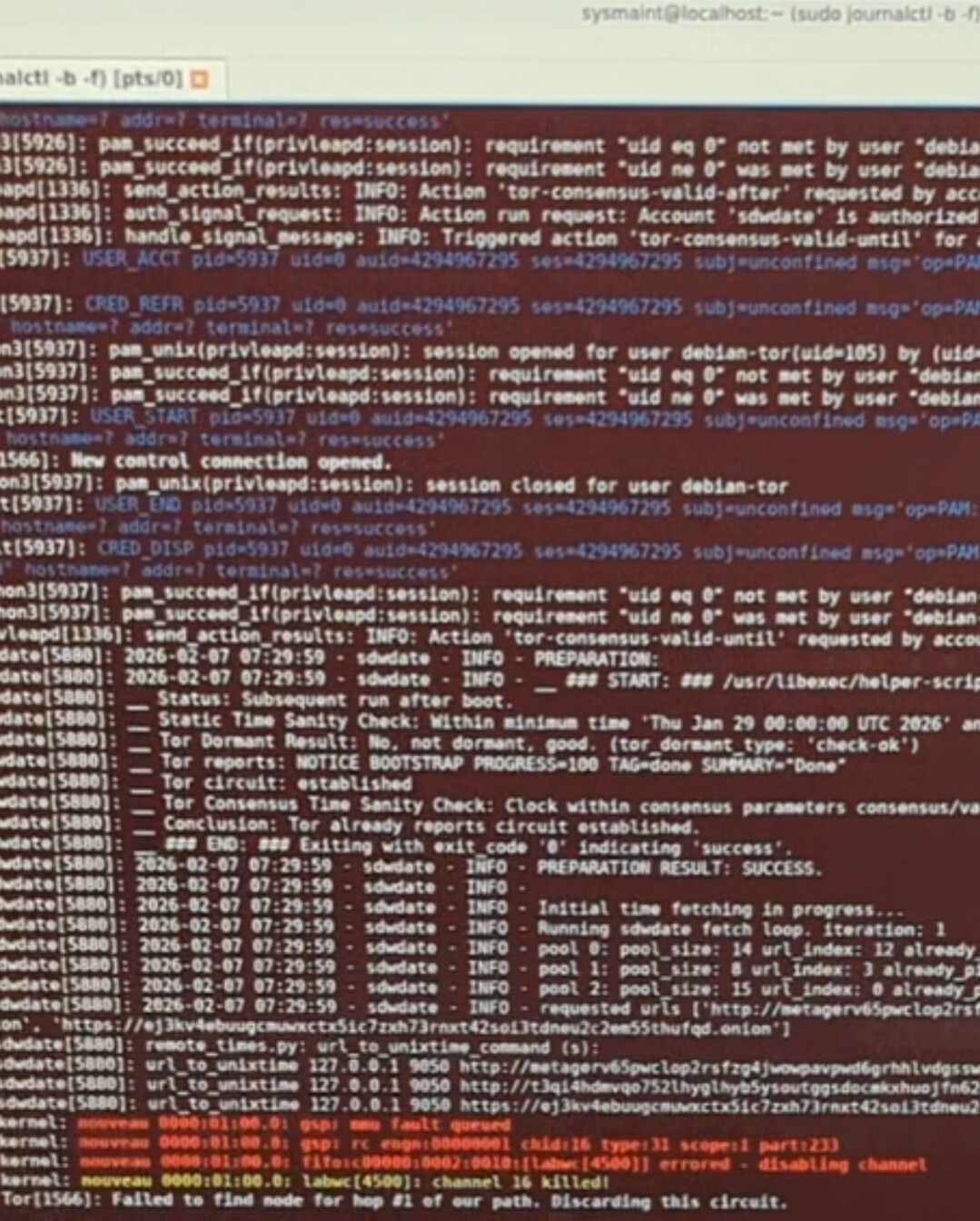

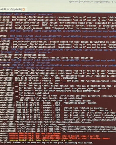

Yeah nouveau is the issue (previous log):
localhost kernel: nouveau 0000:01:00.0: gsp: mmu fault queued
localhost kernel: nouveau 0000:01:00.0: gsp: rc engn:00000001 chid:16 type:31 scope:1 part:233
localhost kernel: nouveau 0000:01:00.0: fifo:c00000:0002:0010:[labwc[2244]] errored - disabling channel
localhost kernel: nouveau 0000:01:00.0: labwc[2244]: channel 16 killed!
New recorded screenshot (then the crash will happen after):
So the OS is sorta unusable when this issue occur, because machine will logout at any moment with no stop.
So might be disable interaction with nvidia hardware by default and we can put it as an option in the calamares installation list and/or in System Maintenance Panel? (also adding the option of either using open source nvidia or the proprietary one).
